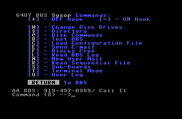

And here is the SysOp menu for comparison with the older versions:
Where's the loaded SysOp menu?

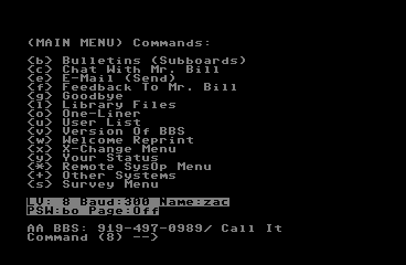

You can see below some screen grabs from a configured system. This configuration is, of course, optional. :)
A fairly full main menu on this version.

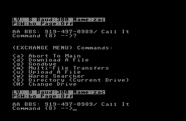

Although it is surprising that the transfer options have been moved off the main menu, it is some consolation that they may be easily moved back with the off-line menu making program.
The default transfers menu-- now separate
